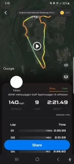

HPL on track at SCCA Track Night in America

Simpson Hybrid S HANS. Only one that is compatible with a 3-point. I'm up to ~140mph on the back straight and ~135mph on the front...it's smart money.
What were those beamers doing, 155-160???
My buddy in an RS3 is hitting 150+, more in his 911. Modded GTIs are 140+. It's a long straight. To hit 140 took me deep into the brake zone more than I'm comfortable with doing all the time but I was hell bent on a GPS-verified 140 in my econo wagon. I chased (and eventually passed...ka-chow!) an Audi R8 - he was at 165 I believe.
