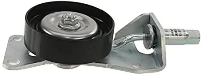

Here's an example of a manual belt tensioner for those that haven't seen one. You can kind of see how it works. Loosen pulley, adjust using the threaded rod, then lock the pulley down is typically how it works. I'm sure there's other designs though.
The 4th gen Maxima uses that design
