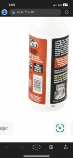

Actually the Lucas does not claim anything about GL4 or Hypoid safe, I checked their photos and the full product data sheet and it is GL5 specific and that can be harsh for GL4 Hypoid gears...

Where is that offered? I'm only seeing this one...
Ok, maybe that’s an old bottle, interesting. But the one on the Lucas website does specify Hypoid.
Yeah, looks like an older product, they may have discontinued that one as GL5 is nearly universally used for hypoid now, only Mazda calls for Hypoid AND GL4, and so far only the RP has the language I like to see in meeting that... and I don't see "hypoid" mentioned at all with the current Lucas Product.. here's the language used by RP:

I wonder what they changed to remove gl4 compatibility. Just obsolete spec? Cheaper/easier to make now?
It does still say hypoid. On the black square. Not a big deal, I just thought it was interesting.
Ah, yes it does on the actual label, but not in the product data sheet... but yes, this makes sense as pretty much ALL hypoid gears call for GL5 now, GL4 is mostly obsolete, so the Mazda spec (Hypoid specific AND GL4 safe) is indeed weird to begin with! So yeah, RP is the only one that says is specifically a Hypoid gear oil *and* also safe for GL4 gears which are softer metals, so that was the only one with the full language I liked to see... (Edited comment above to add an additional bit I missed in the RP description)...
