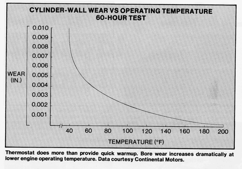

There is always some wear going on while the engine is running, but it's true that certain types of wear is much more rapid before the engine is warmed up, especially the cylinder rings and bores. This is one reason why over the road trucks can last a million miles between overhauls. They often get driven 500 miles or more between cold starts. This is the reason why oil viscosity is a non-issue in terms of start up wear.
I believe the chart below is from the famous 1950's SAE paper on how engines wear.
cylinderwear_temperature-png.213542
