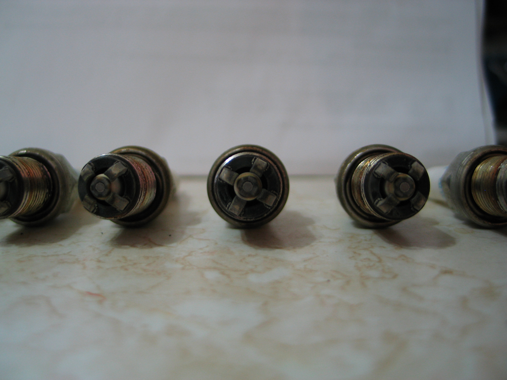

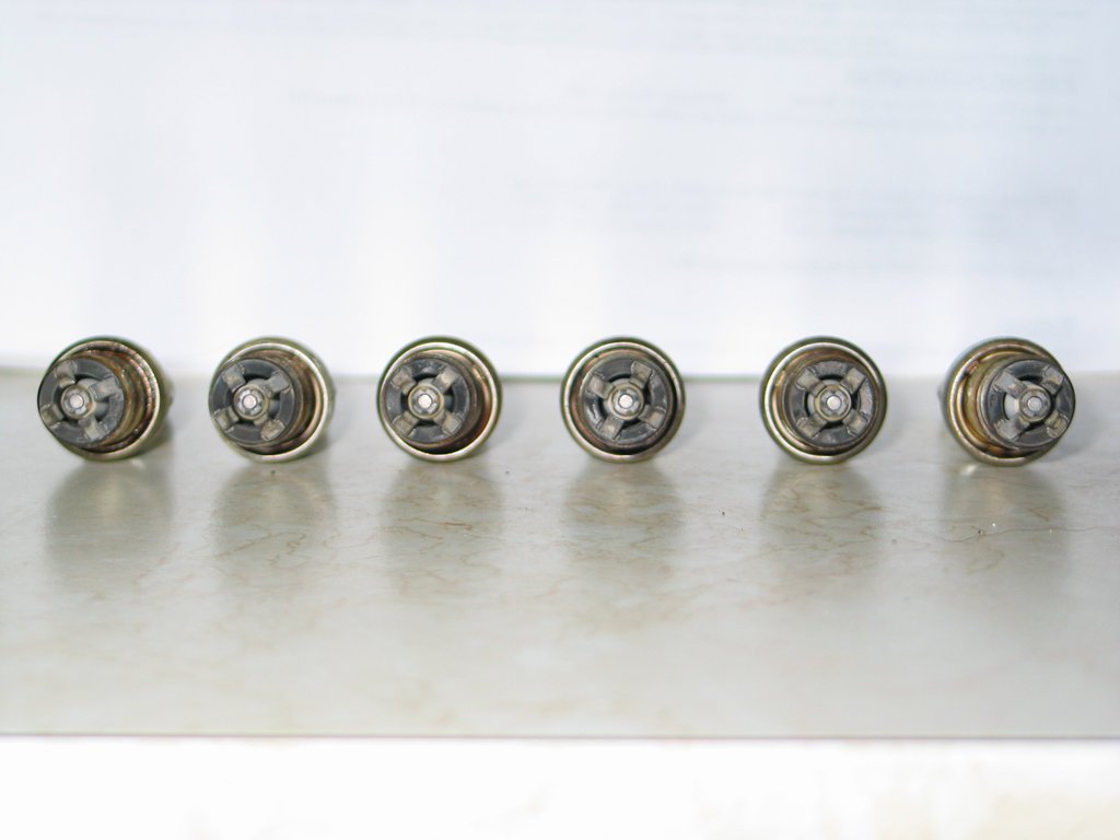

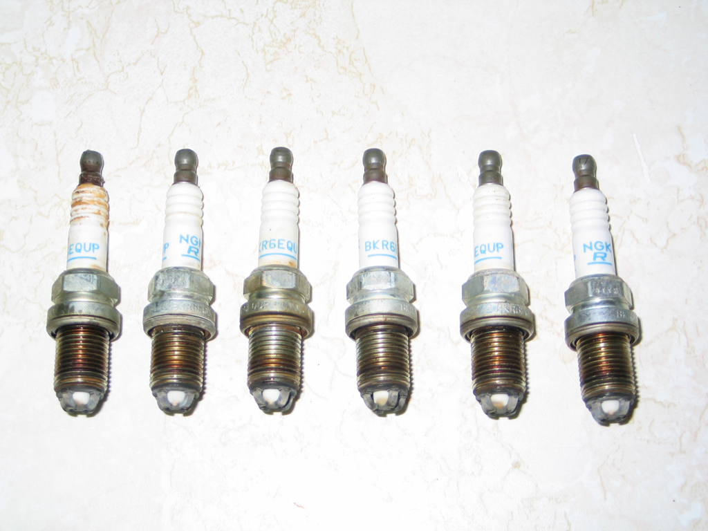

Engine has 256,000Km's on it.
Pulled these today because the car was "bucking" under load (like when climbing a steep hill and it wanted to hold the gear), which I assumed was a probably a misfire.
Issue is now gone since I changed the plugs. Since I don't have the service documentation for this car, I don't know when, or if, these were ever changed.
Comments are welcome.
Oh, and I put regular NGK "G-Power" fine electrode Platinum plugs back in. Plugs on this car are like a 20 minute job, so I'm not concerned about having to do them on a slightly shorter interval going forward.
Originally Posted By: Coprolite
What is the gunk on the wire end of the first plug?
Appears to be dielectric grease.
Those don't appear to be too old, however they do appear to have been in a hot running engine based on the overall grey deposits (instead of tan) and maybe the heat discoloration on the threads.
I don't know if your car has an EGR system, but if it does that could explain the high heat if its not working.
The bucking you experienced could have been pinging/detonation as a result?

I've never had tan plugs on any of my EFI engines, they are always pretty white. These are no different in that regard.
Yes, it has EGR, and considering how well it did on its E-test, I'm going to say it is working properly.
These plugs, like on a Modular, are located down a 6" deep plug well, so I'm quite sure they get very hot.
Consider the Denso Iridiums for next time if you don't mind changing them a bit more often -- the super-sharp electrode is unmatched from any other manufacturer.
Your plugs don't look too bad, actually.

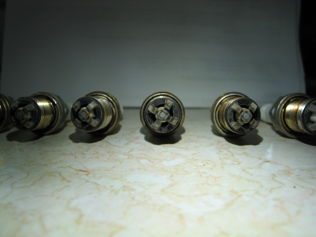

No, I didn't think they looked bad either, just worn. Which I think explains the misfire that is now no longer occurring.
Oh,and it is hard to tell from the pics, but the centre electrode is a little recessed into the porcelain on them as well.
I'd say that right there is why you were having problems. If center electrode is recessed, spark has to jump much further, and around an obstacle.
Good thing these were changed when they were
Exactly what I was thinking
Also, the electrodes are worn quite a ways in (I assume they are flat across when new like the Bosch ones are, while these have significant curves into each of the electrodes, as you can see in the pic) making me think they have a fair number of miles on them.
