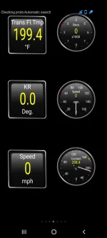

I recently got torque pro and a bafx scanner and my Trans Temps have been as high as 180-200 degrees on 70 degree days.
Let it cool down for 20 minutes, then went for a 10 minute drive.
How long did it take to get to 200F? 170-220 or so is considered normal operating temperature for an automatic transmission.
Pretty quick. I drove it about an hour, parked it 2 1/2 hours, came back and on the drive back it hit 200 degrees. Maybe 20 minutes.
