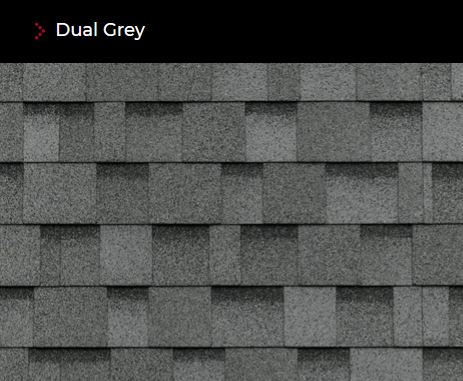

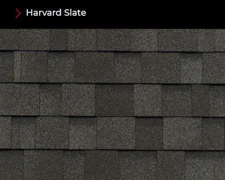

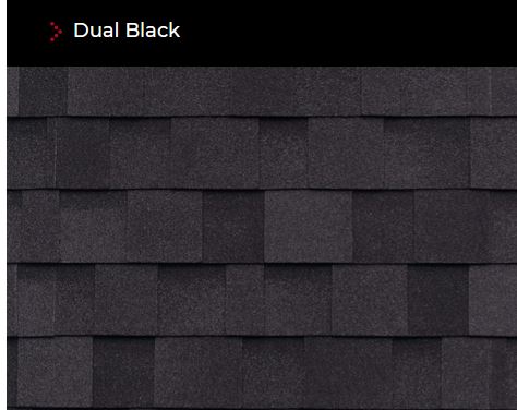

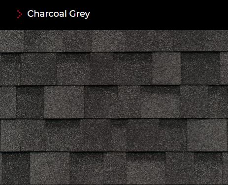

Black might be off the table, but a darker color is still preferred. With the options below, will there really be much of a difference since they are all darker? It's not like we are considering black and white which would be a significant difference as some have mentioned.
