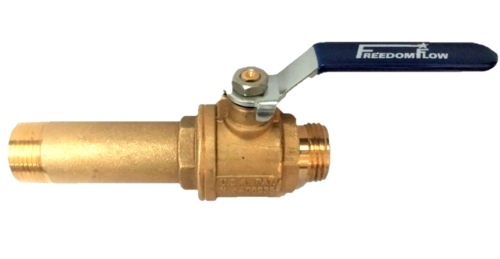

I ended up taking out both heater elements. They were surprisingly decent looking for being 19 years old. I looked in the tank with a flashlight and saw a bunch of sediment on the bottom. I ended up taking the train valve out and flushing all the sediment out. I then took my wire wheel to the heater elements and cleaned them up. I reinstalled everything and its quite a bit different. Before i ran out of hot water after a 20 minute shower. Now it runs out after a 45 minute shower. I assume cleaning the heater elements had the greatest effect. The dip tube looked fine and was intact when i looked inside.
