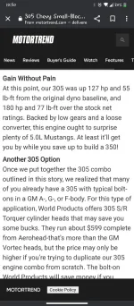

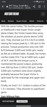

Car craft also tried it, here's what their results were with cheap aftermarket heads.

It could have been Car Craft, it was a long time ago…
Thanks!
There were a few articles like that one I remember reading back in my younger days when I still had a 305.
