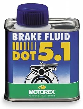

Now a DOT 5.1 brake fluid is another matter. I've bought and had someone work on it for me. I've bought Motorex, Motul, and Wagner.

DOT 5.1 is glycol as well and is at least theoretically compatible with DOT 3 and DOT 4. The DOT 5 stuff is the silicone-based stuff that is certainly not compatible. In any event, I don't see a lot of DOT 5.1 stuff on the shelves, and not at good prices, either.

The European or Japanese DOT 5.1 fluids are kind of exotic and generally sold at specialty retailers like speed shops or motorcycle shops. I actually bought my first ones at a motorcycle parts dealer online. The one question was "What the heck do you need this much for?" I told them it was for a car. They also had Motul Gear 300 cheaper than any other place I could find.
The Wagner SevereDuty DOT 5.1 fluid I bought was special ordered at a regular retailer. However, they had it as a part number that could be ordered.
