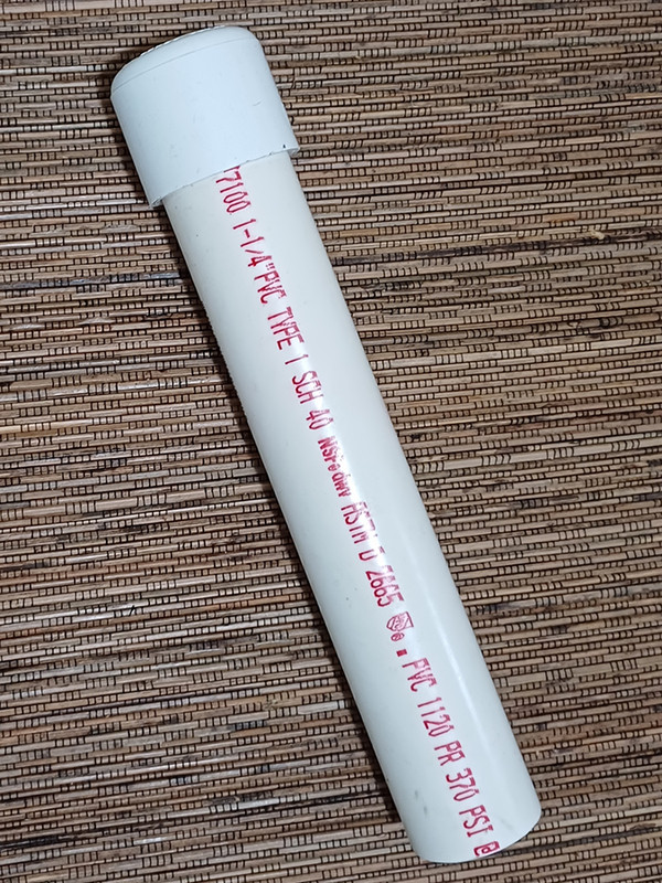

You can easily install a new bottom race with a homemade tool made from PVC tubing, a PVC cap, and using a mallet. My LBS wanted $40 for pressing on a new race. I laughed at him when he showed me his special tool that looked like something NASA might use. I was still laughing when I was leaving the shop.
To get the old press-fitted race off, hammer a knife blade between the race and the seat around the perimeter until the race comes off the tapered tube.
Can't quite picture this, sounds like a good way to chip paint off of the frame. Before I got the NASA grade bike tools I just used a long straight blade screwdriver reaching through the headtube and tapping around and around on the ridge of the bearing cup easing it out. A long enough piece of 3/8" round steel rod with a nice crisp edge works well too.
The PVC tool is genius. (y)
