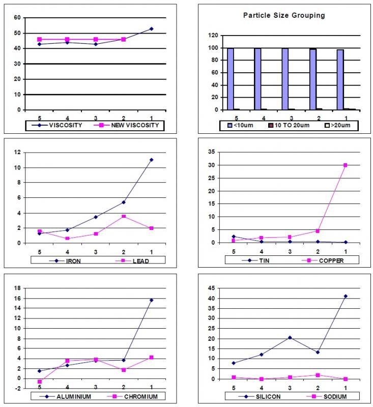

Fuchs GT1 XTL 0W20 - 1,982km- 2010 Honda CR-V 2.4L
Nov 7, 2008
57
Townsville, Australia
Sample 1 - Factory fill - 1,145km - OCI 7 months
https://bobistheoilguy.com/forums/ubbthreads.php?ubb=showflat&Number=2271195
Sample 2 - Fuchs Titan GT1 0W20 - 4,299km - OCI 6 months
http://www.bobistheoilguy.com/forums/ubb...333#Post2486333
Sample 3 - Fuchs Titan GT1 0W20 - 3,482km - OCI 6 months
Not Posted
Sample 4 - Fuchs Titan GT1 XTL 0W20 - 1,674km - OCI 6 months
https://bobistheoilguy.com/forums/ubbthreads.php?ubb=showflat&Number=3008373
Sample 5 - Fuchs Titan GT1 XTL 0W20 - 1,982km - OCI 6 months
Comments on report:
Wear metals are within acceptable limits.
Oil condition appears satisfactory.
Driving Conditions:
30% City 70% Highway driving
Refilled with: Fuchs GT1 XTL 0W20
Filter: Honda
OCI: 6 months (Honda interval)
Thanks for posting.
Looks good.
Where did the moly come from in the latest sample?
I realize you're following the recommended oil change time period literally but, and I think I've mentioned this before, with such limited mileage I would definitely be extending the OCI based more on mileage and not time.
Dumping this expensive super premium ester based synthetic so prematurely is a crime.
If you decide to go with time with such low mileage then find the cheapest xW20 in your area, it will be more than adequate for 8-10k km.
