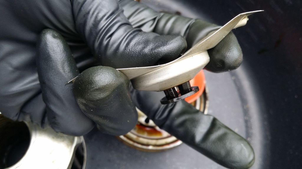

This was through 2 OCIs on my Navigator. ADBV was still pliable. Bypass still operable with good spring pressure. No drama in the media.
Waiting on UOA. No way of knowing otherwise if it was still filtering or just bypassing a lot. Time will tell. I didn't notice anything in the can except for metal shavings from the saw I used. Drain plug had precious little on its magnet.
Looks great, the more I see these cut open the more I am believing that the 15k rating is conservative.

It is absolutely Fram Ultra is capable of more than 15k miles in a good/clean engine, as long as not much fuel dilution.
That's just the thing - you don't know if you're in bypass mode. Without paying for a particle count, will a UOA tell you if you were in bypass mode?

However they could make it better with a COIL Sping on the bottom and a TOP by pass valve.

The important Secondary issue is the media was strong. I could not physically harm it nor dismount it from the end caps with my hands.
