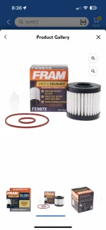

I’m gonna have to wait and see these in person. The only way I could get them now is online and with shipping it comes to $20 per filter. I do like that they use the champ style end caps for the cartridge filter though 👍🏻
