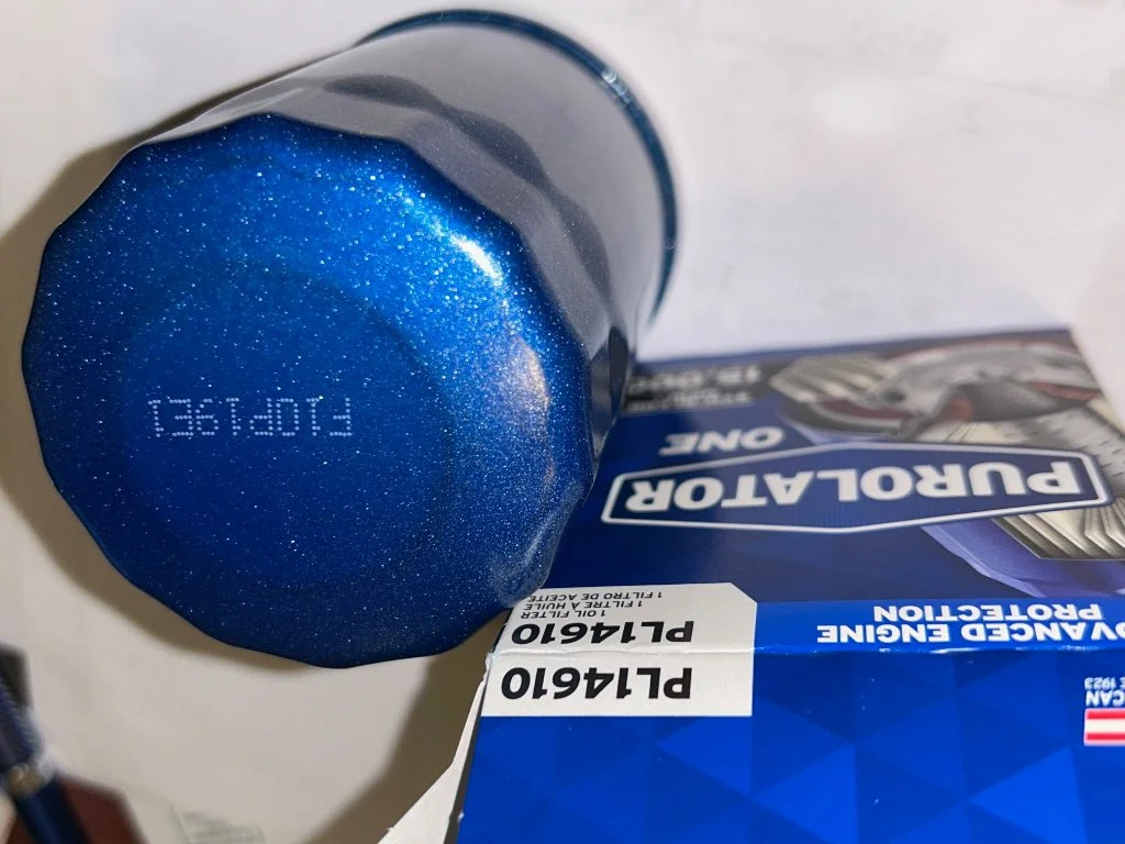

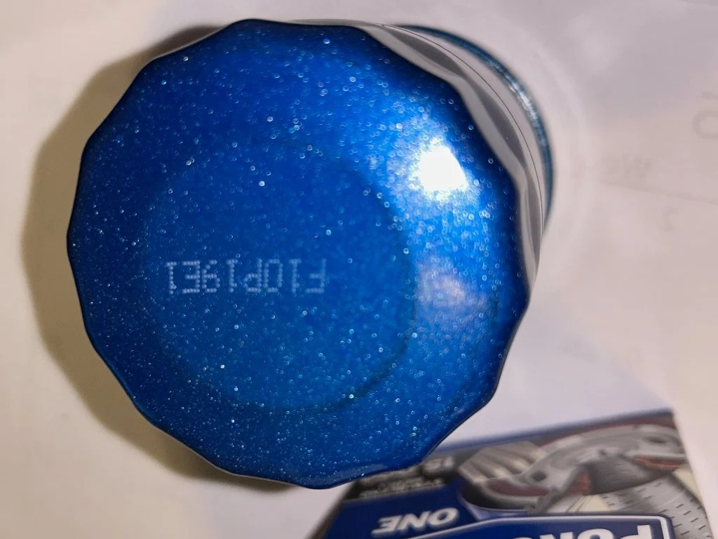

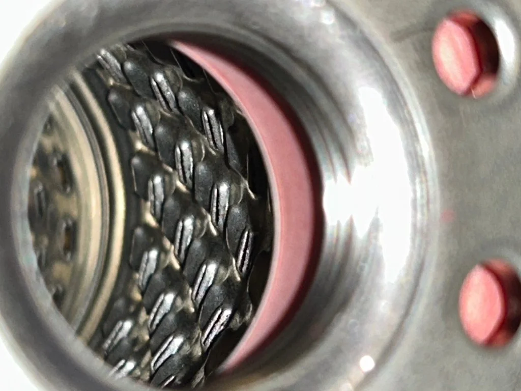

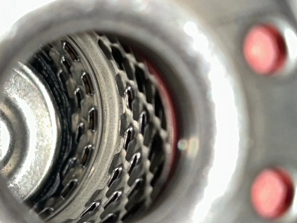

Not a Fram, a Pure one - but here is some a month ago. I returned them. First trip to the oil filter forum sounds like? :ROFLMAO:
The louver thing with Fram is new - they used to use holes. Wix and others have had this issue at least a decade.
Just curious, how many closed louvered filters have been shown here? Or, have these sightings been discussed by someone who heard this from their brother-n-law’s neighbor’s cousin who lives in Far Away No Where Arizona?
As shown above, closed louvers are real. Always inspect them before buying or spinning on a filter that has louvers.
