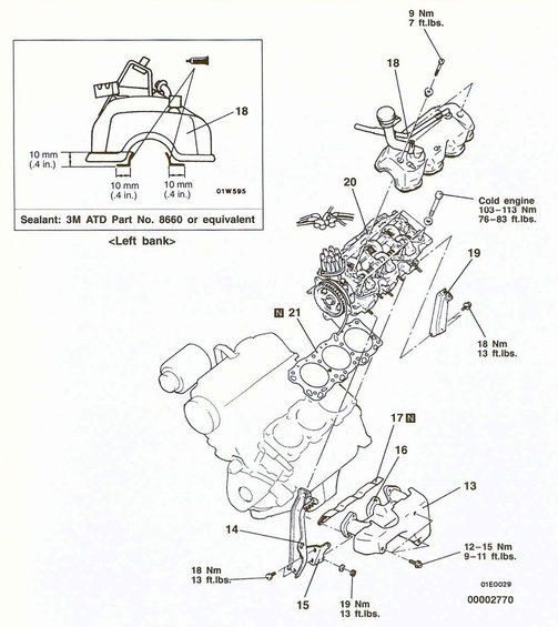

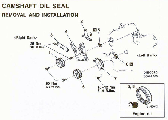

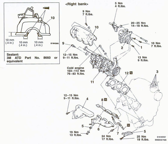

This is definitely going to be good fun. Done the timing belt before, but this looks like even more fun: Will have to dig out some more exploded diagrams to transfer the distributor across. Would it be alright to coat the new seals with synthetic oil and a touch of ARX?
