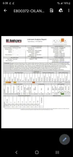

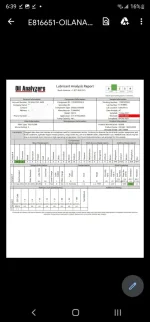

History:
Truck emissions were intact when I got it and had had engine work done (top end).
The engine did get some dust for about 3000 miles right after I bought it. Someone right before I bought it had put the wrong air filters in it. I happened to see the filter moving in the housing about a week or so after getting it.
I put in the correct filters, tested oil and changed it immediately and the test showed high silica.
Did another couple oil changes and silica was way down...but there was still a little iron and chromium and other wear metals. This was about a year ago.
Couple months later, I decided to switch to synthetic Valvoline 5w40. About a week or so after that, my filter plugged. Thinking it was a bad filter, I changed it and it stayed good after that. But then it started using oil and even after switching back to conventional...it hasn't stopped. And now a year later, plugged filters after an oil change again.
So, I've been expecting an inframe since the dusting...but this oil filter plugging is strange to me. Engine still runs great but power might be down a tiny bit. And oil consumption is getting high.

Here are the two OA from that time.

Rings and liners are are shot.
