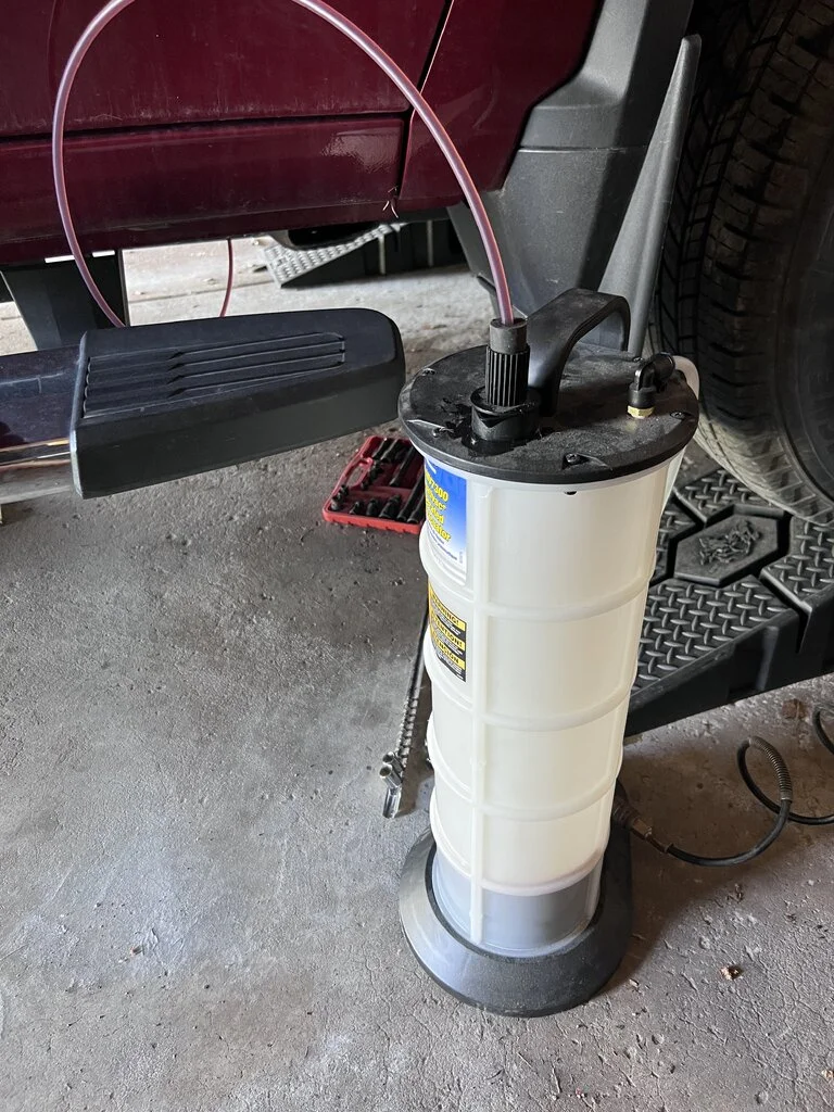

I have a Mityvac vacuum extractor, which is an awesome tool. After a discussion with @Trav I will be replacing the injectors as well. They aren't that expensive and since I've got everything apart I might as well replace them.
