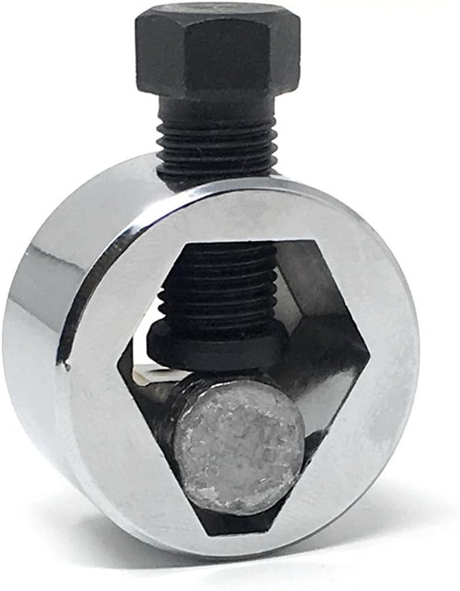

Yep, welding seems drastic when there are the "Nut Extractors" (shoot, why do I hate that name?!?!?)
[Linked Image from images-na.ssl-images-amazon.com]
No room for that in this case. I may have removed a thousand or more bolts for one reason or another by welding on them. I welded in a machine shop for nearly 24 years. Welding makes a secure way to loosen bolts and the heat will most often help to release the bolt.
