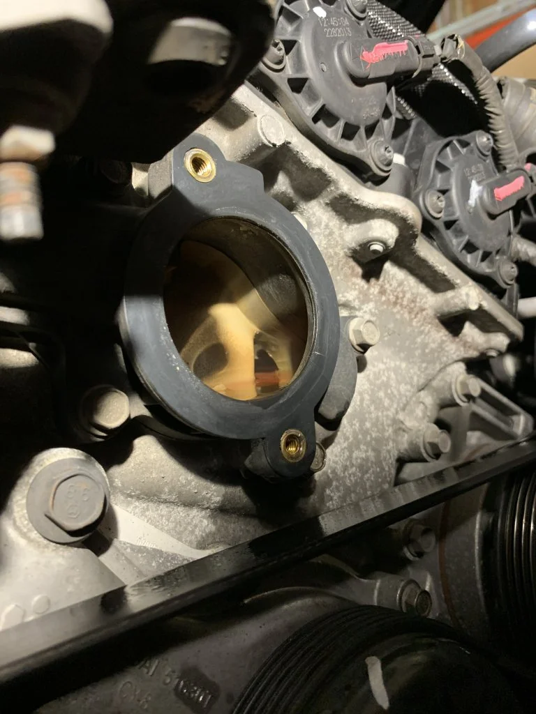

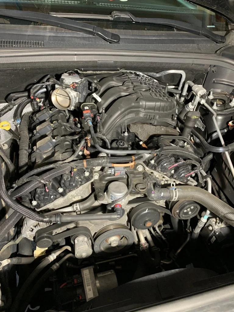

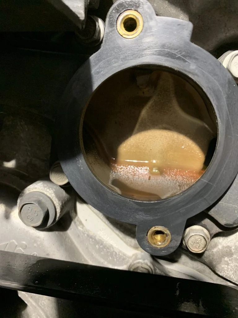

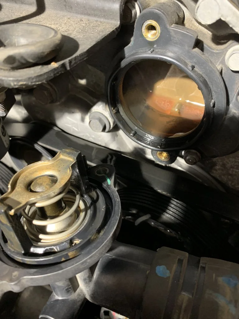

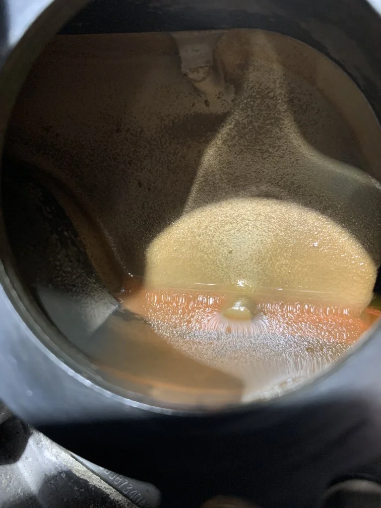

I put the new thermostat in today, which is a very simple job that took about 15 minutes. The intake runner covers the work area, but the runner comes off by loosening two hose clamps and unhooking a wiring harness. At 130,000 miles there was little if any corrosion or coolant mud in the system. OAT coolant was used for top-off per the urging in this thread.
It is surprising to me the old thermostat wasn't open when cold. It must open at a much lower temperature than it should. I burped the system and drove around for a while. The temperature gauge now goes quickly to the normal range and stays there. Before the temperature gauge took a long time to reach anywhere close to normal and now I realize it hasn't run at the normal temperature for a long time, like a couple years.
Cruising down the interstate today at 40°F the oil temp was where it should be. With the original thermostat, the oil temp would have been about 160°F, which is too cold. The Durango had a bad thermostat almost since new. I wish I had realized the issue and replaced it long ago.
