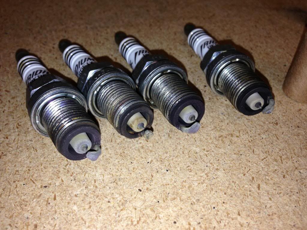

do these iridium plugs still have life?
Feb 6, 2012
854
Philadelphia, PA
Found these at my friend's garage, he says he doesn't know where they came from or when. I might have a use for them if they have at least half their life left.

The plugs may have some life left but the spark plug gaskets should be replaced.
If those are the Iridium IX plugs, they do not have the platinum pad welded to the ground electrode and that'd be the part that will show wear. I believe the IX plugs have a finer tip than do the Laser Iridiums. The Laser Iridium have a platinum pad on the ground electrode which wears at a much slower rate. So in this case, I'd measure, and likely, the gap has widened from factory pre-set gap. NGK says not to gap Iridiums, and I certainly wouldn't attempt to open the gap with a tool for fear of damaging the iridium tip, but some very gentle pushing on the electrode may work to close the gap to spec. Those plugs look fine; the torque feel is going to be a bit different when tightening since the washer appears to have already been crushed.

Theyre beat. Those plugs have a needle point on electrode and you cans ee the varying wear on the grounds. Are they BKR6EIX? If so pricey little guys
