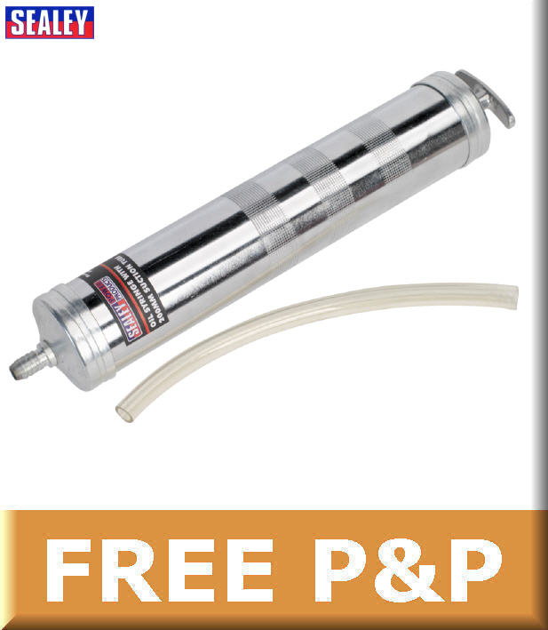

For the 4L60E, I use one of these, and a long tube...
Gives the shoulders a decent work-out, pulling a vacuum (you feel it when the air column separates, and you feel it when it collapses again).
Did the cooler line flush a few weeks ago, and I get more out with the cooler than the suction, as I can pump the pan out, and not get anything with the suction hose.
