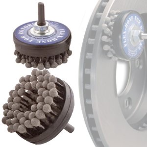

I think I've mentioned these before: for $40, they're one of the best gadgets a DIYer can buy.
Brush Research Flex-Hone for brake rotors
Amazon has several offerings for these. I'm thinking that this may be what I need to cure the brake shudder on my 13 GC. What grit do you recommend, they come in course, medium and fine.
