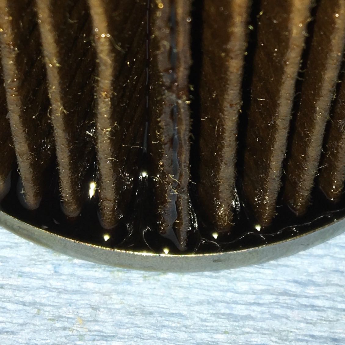

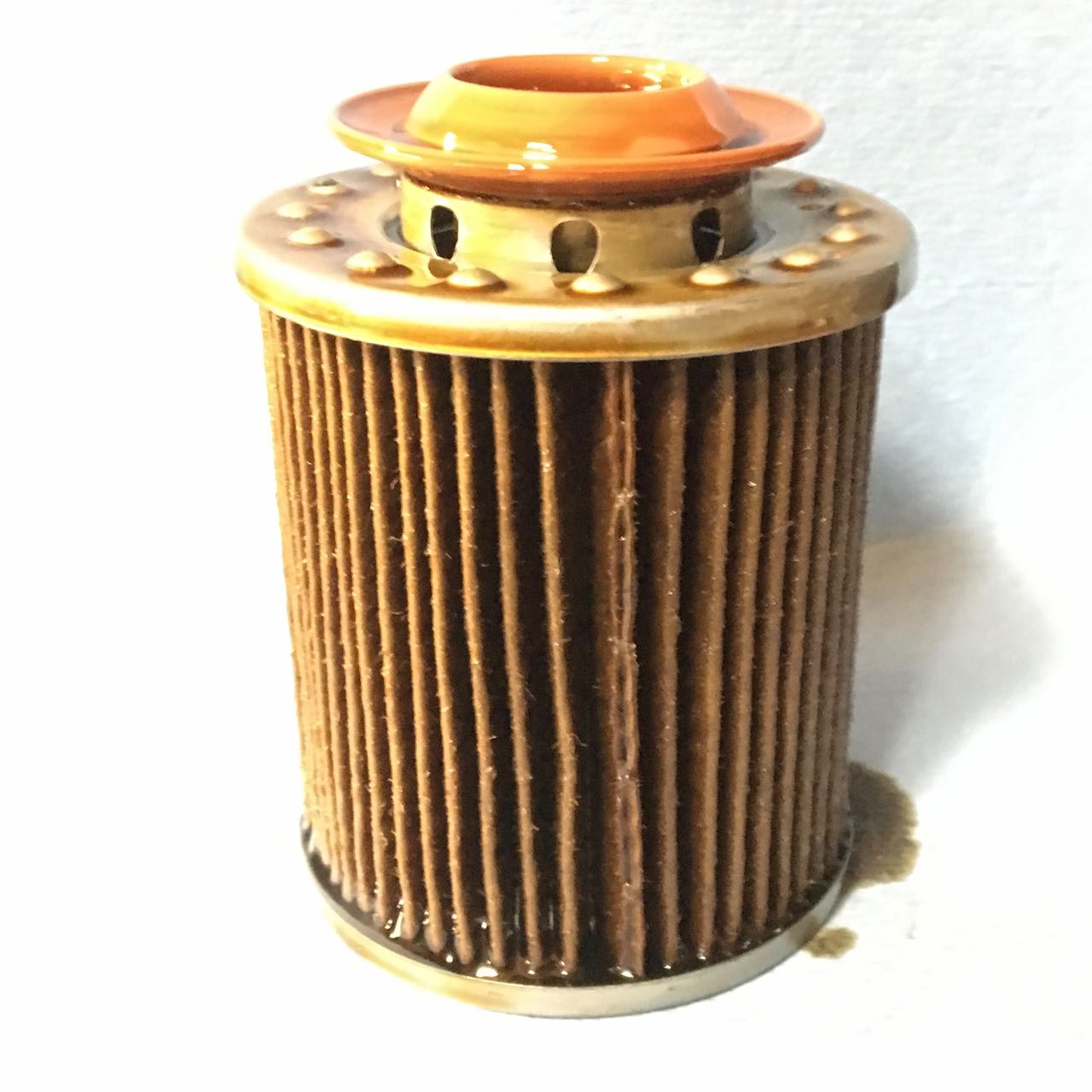

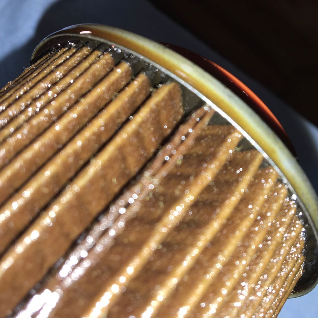

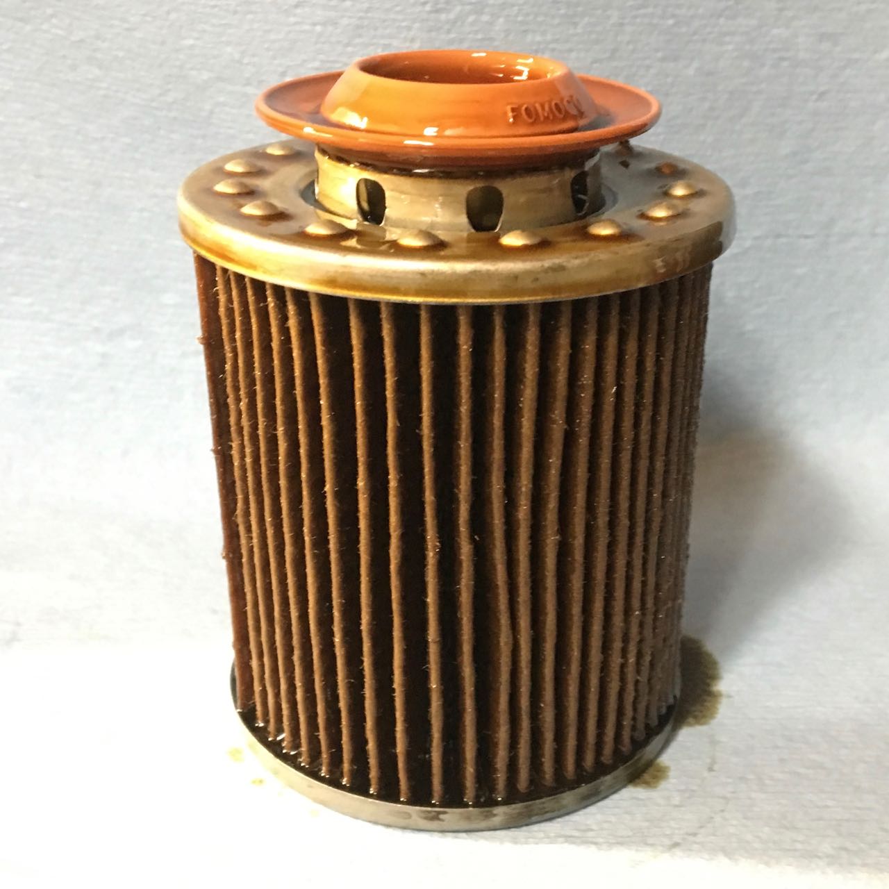

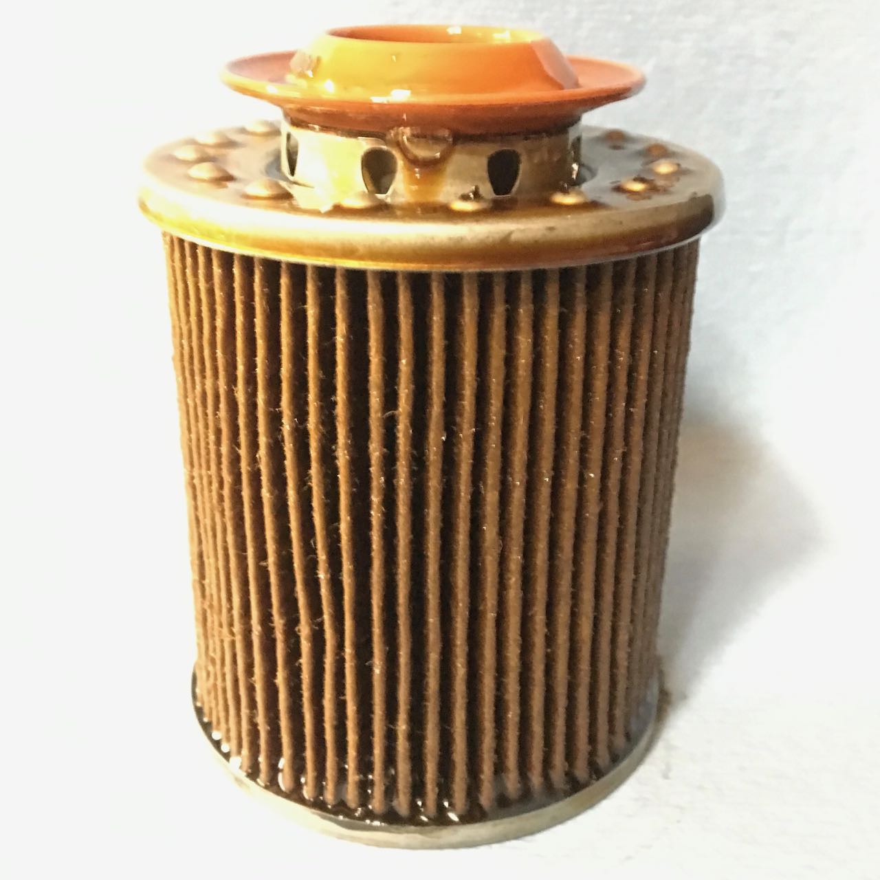

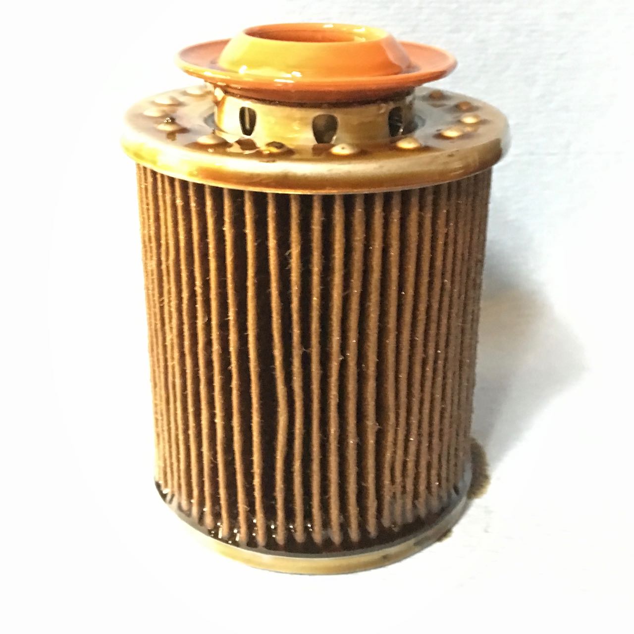

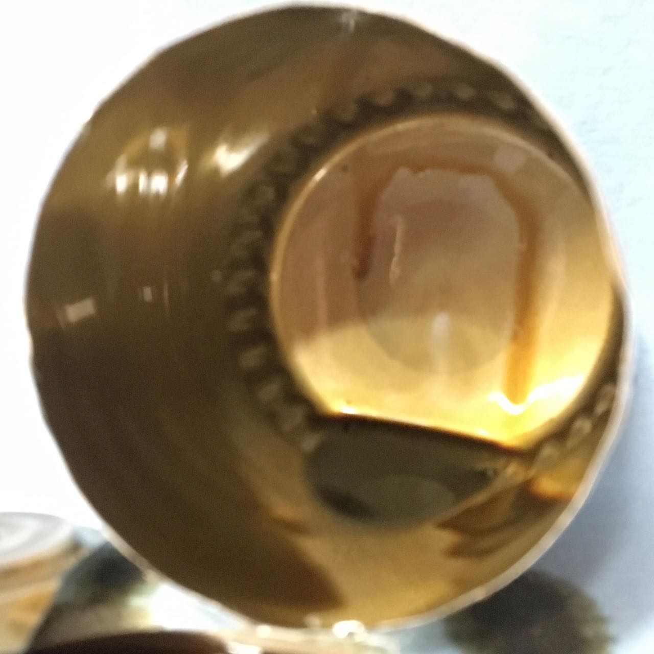

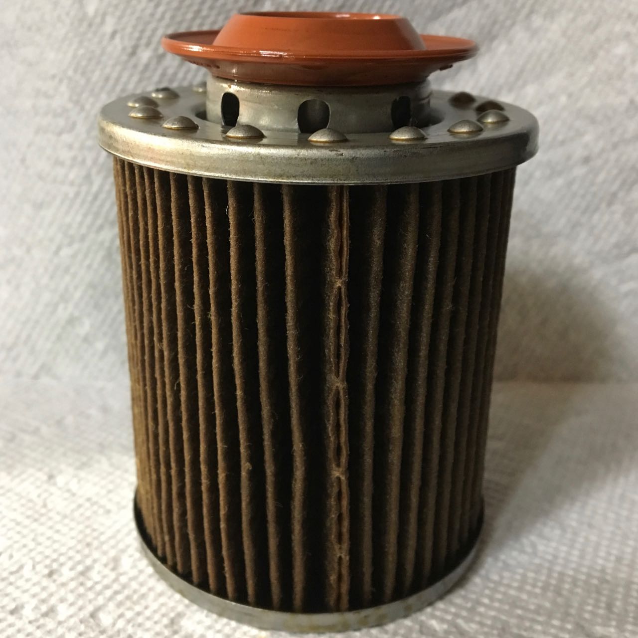

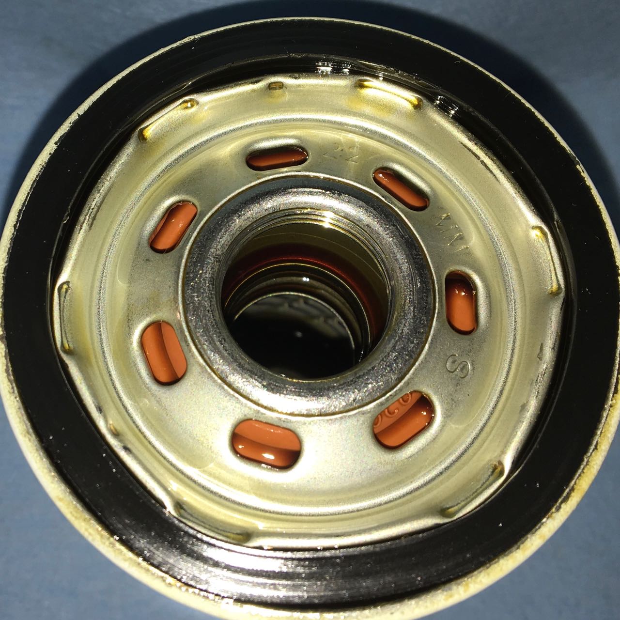

Shorter than usual run due to schedule and also drastically fewer hours running and idle than typical. UOA in the mail, filter element drying out...
The FL-500s does not seem to be plagued with the issues the FL-820s has. If every MC/Purolator filter looked this good, some faith may be restored. Thanks for the C&P!
What car and oil was used for this run? Looks like the filter was never used/dipped in fresh oil and pictures taken.. good clean engine and easy on oil whatever it was.

No kidding!!! Nothing I own ever drains that clean after 4220 miles!

Sometimes the FL820S media will tear near the seam. Dome end tear. Thread end tear. The subject filter looks very good indeed. I wish all the Motorcraft / Purolator filters did this well.

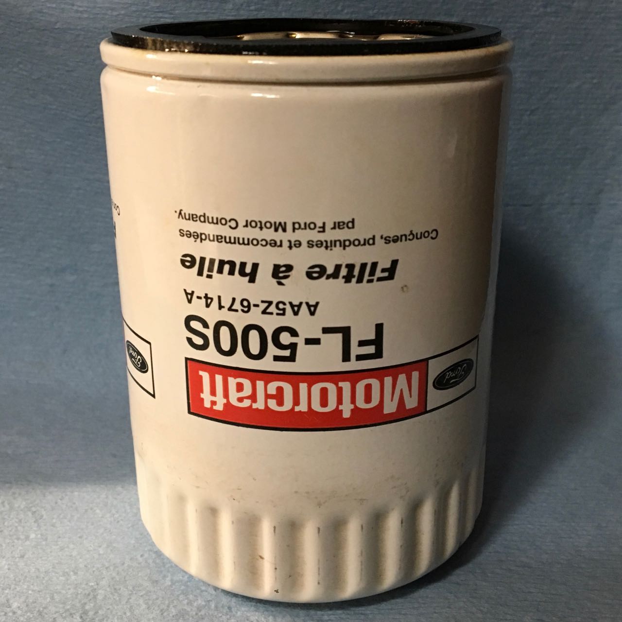

Though the FL-500s is specified for my Explorer, I use Ultras. Ultras are $4.99 each on eBay in 6 pack quantities and while MC FL-500s filters are $4.40 each in 12 pack quantities, for a $0.60 difference I have no reason to look at MC filters. With that said, these newer MC filters (FL-500s, FL-920s, etc.) do not seem to have any issues.
Looks excellent to me at ~4200 miles. 'Generally speaking', in my observation, excepting some 820S the MC filter anecdotes posted including the 500S and 910S have looked good. Thanks for c&p.
is this the same size as the FL400S just with a 22mm thread? I know the 400 has a 3/4-16 thread and I have a few I'd be willing to run if they look as a good as this.
I don’t have a 400S on hand, but have some equivalents (XG3600, M1) and they are approximately the same size.
