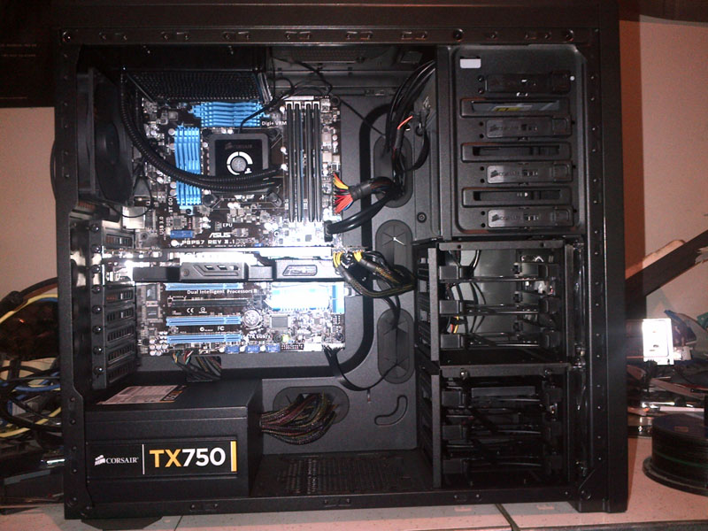

A buddy of mine got a hold of me last week asking me if I could build him a new system.
Ended up with:
-Corsair 500R case
-Corsair TX750 PSU
-Corsair H80 Water cooling kit
-16GB (4x4GB) Corsair XMS3 RAM
-ASUS P8P67 Motherboard
-ASUS DVD-RW
-ASUS Radeon HD6950 Video Card
-Patriot Torqx2 128GB SSD
-Intel Core i5 2400 CPU
-Philips 27" Monitor
"On the bench" getting loaded:

I've got to ask, why the watercooling rig? Are you planning on overclocking the snot out of it? If not...????
Much quieter under load (no fans to ramp up really), keeps the CPU much cooler, and keeps the rest of the case cooler, by exhausting the heat directly outside the case.

That looks like a nice case, good wire management.

Thank you. This case makes proper cable management a breeze, I like the clean look you can achieve with it without having to add your own holes.

The water cooling is a bit of overkill for that small of an overclock, but it was inexpensive and if he decides to upgrade the CPU later to one that is overclock-friendly, he'll have plenty of cooling headroom.
He's never done overclock before however, so I don't know how interested he'll be in doing that. This was part of the reason for the CPU choice to begin with. It was inexpensive and didn't have to be an overclocking monster.
