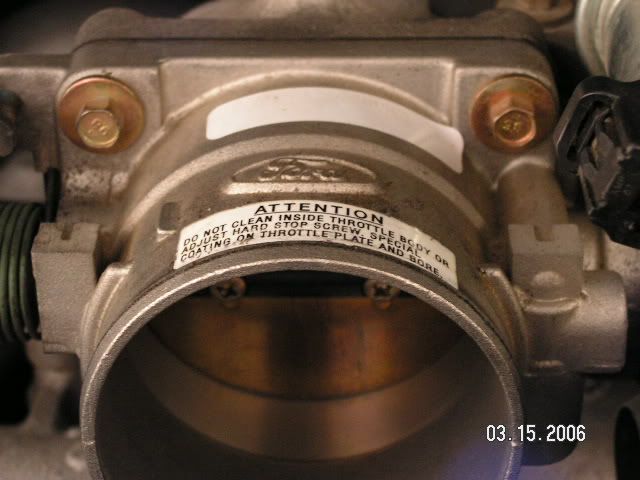

No amount of fuel treatment will clean the throttle body. Fuel enters the engine beyond that point. One engine manufacturer (don't remember which) used to say never clean the throttle body (butterfly)because it had a coating on it that would be washed off with the cleaner. Maybe by now the cleaners are milder to address that.
quote:
Originally posted by another Todd:
....One engine manufacturer (don't remember which) used to say never clean the throttle body (butterfly)because it had a coating on it that would be washed off with the cleaner.....
That would be Ford. The warning is stupid, because it didn't keep the butterfly in this picture from looking like the inside of a chimney at 75k miles. I cleaned it with TB cleaner at that time & it has looked about as good as it does in the picture ever since.
Same here. My 98 ZX2 says the same thing. Not much of a coating if deposits build up. I simply go to town with my solvent of choice. Perhaps gasoline is the safest solvent?
