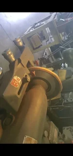

I would venture to guess that the lathe you were using was the source of the runout. In all my years in this industry, I've never seen a rotor, even from the worst sources, that had anywhere near the type of runout you describe. Measure runout while the rotor is installed on the vehicle hub....mark the high spot and low spot on the rotor with a sharpie, then re-clock the rotor on the hub and check it again....if your marks line up, then all the runout is in the rotor. If they move, then the runout is in the hub. Throw it on the lathe and check it again....if it changes, the runout is in the lathe.
The braking with those new Akebono pads/rotors felt wonky from the getgo, like rotors with material build up. The rotor lathe has been in my friends shop for 40 years and he's cut, I would guess, thousands of rotors with it. The way the rotor clamps down, I don't think it's possible to make a mistake. They feel perfect now. Here's a pic of one of the fronts, you can see how a large area wasn't even contacting. That rotor is held on with a giant reverse thread hub. Now, since he was controlling how many thousandths came off on each pass, perhaps that's variable, he did rough cuts removing 4 thousandths and a fine cut at the end taking off 2. He was also very surprised though.

Tell your buddy to install that inboard adapter on his lathe with a bunch of spacer and a nut....then face off the adapter.
Take an old scrap rotor and machine it on the adapter as it sits now and then reinstall it on the faced off adapter and check runout...I bet he'll see a bunch.
