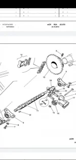

It is unsealed and excess can run out freely. Grease is applied to part #22 that rides in the tracks of part# 11
