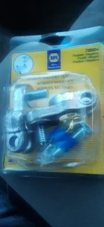

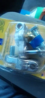

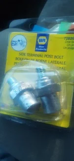

Just too pics these are what ide like too install using the side terminal cables. Would it work?

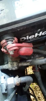

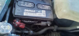

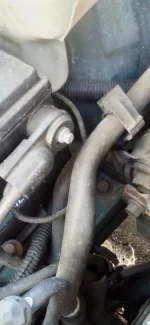

These are what I want too replace with previous pics. Can it work?

You would have not one but two adapters in there. Super janky. Don't do it.
If you split that insulating red cover off you'll find a solid metal connection underneath. Maybe clean it up a little but put it back the way it was.
