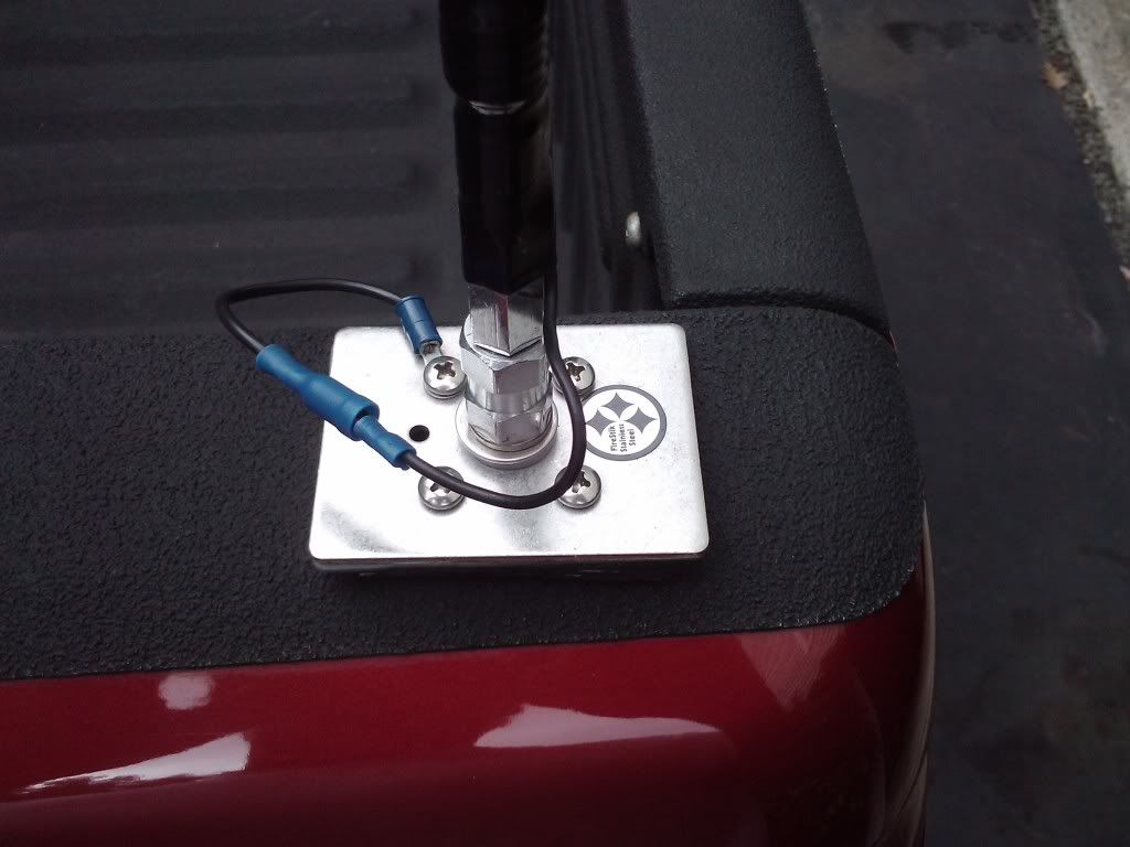

I have a stake pocket mount for my antenna. It's basically tqo pieces of sheet metal that sandwiches the bed rail. No hole needed.
[img:left][/img]
Then, I found an unused grommet in the floor, right behind the door. You don't have to go through the firewall.
