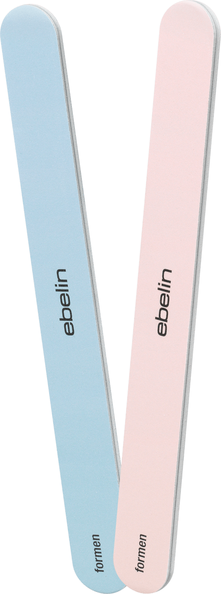

It shouldn't happen, but it happens sometimes, even with reputable brands like Ferodo, Textar etc..
Probably it doesn't require a workshop 'file', quite often these are appropriate, just to trim back a bit of paint from the pad's ears:
ebelin-nagelfeile-sensitiv
