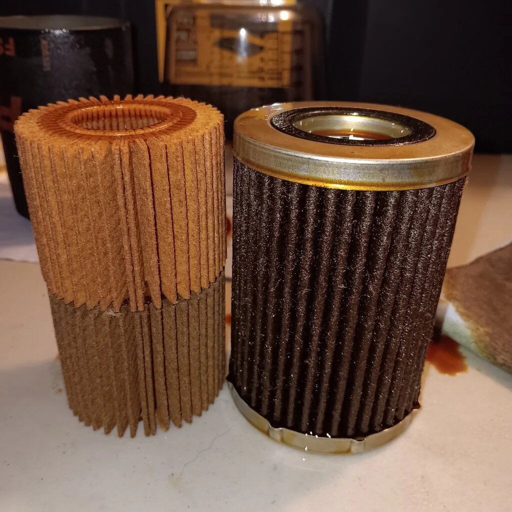

I bet its probably double the height, here is a comparison of 2 Toyota YZZN1 media stacked next to a FS3600.
Should've kept that old XG4967 years ago to cut open after use, wire backed ones are harder to find compared to the FS3600, I'd imagine the difference is comparable to the pic here.
