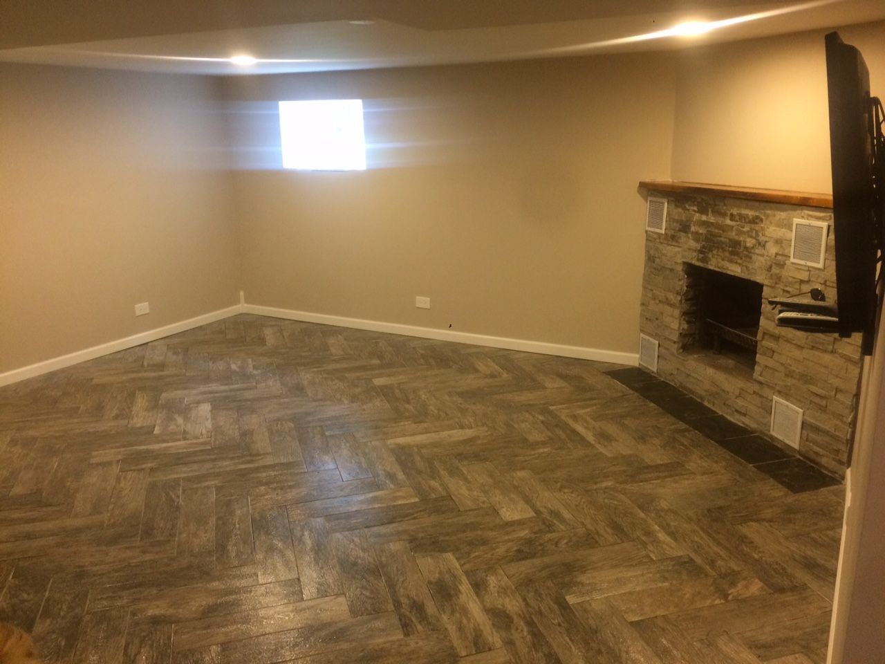

Today I finished grouting the tile in my new finished basement. I did everything of the course of the past two months.....
Never got water before.
I have a sump pump. That wasn't the issue.
I got 5 inches of water today up through a floor drain. It's rain water. We had a quick HEAVY storm.
None of my neighbors got water in my populated area. Our homes tie into the same line out.
I'm sitting here with a sump pump cycling it on and off over the floor drain as water is still creeping in.
I have 10 fans all borrowed from said dry neighbors hoping to salvage drywall.
I'm confused to why I'm the only one with water?
I'm also distraught over that hard work I just put in.
