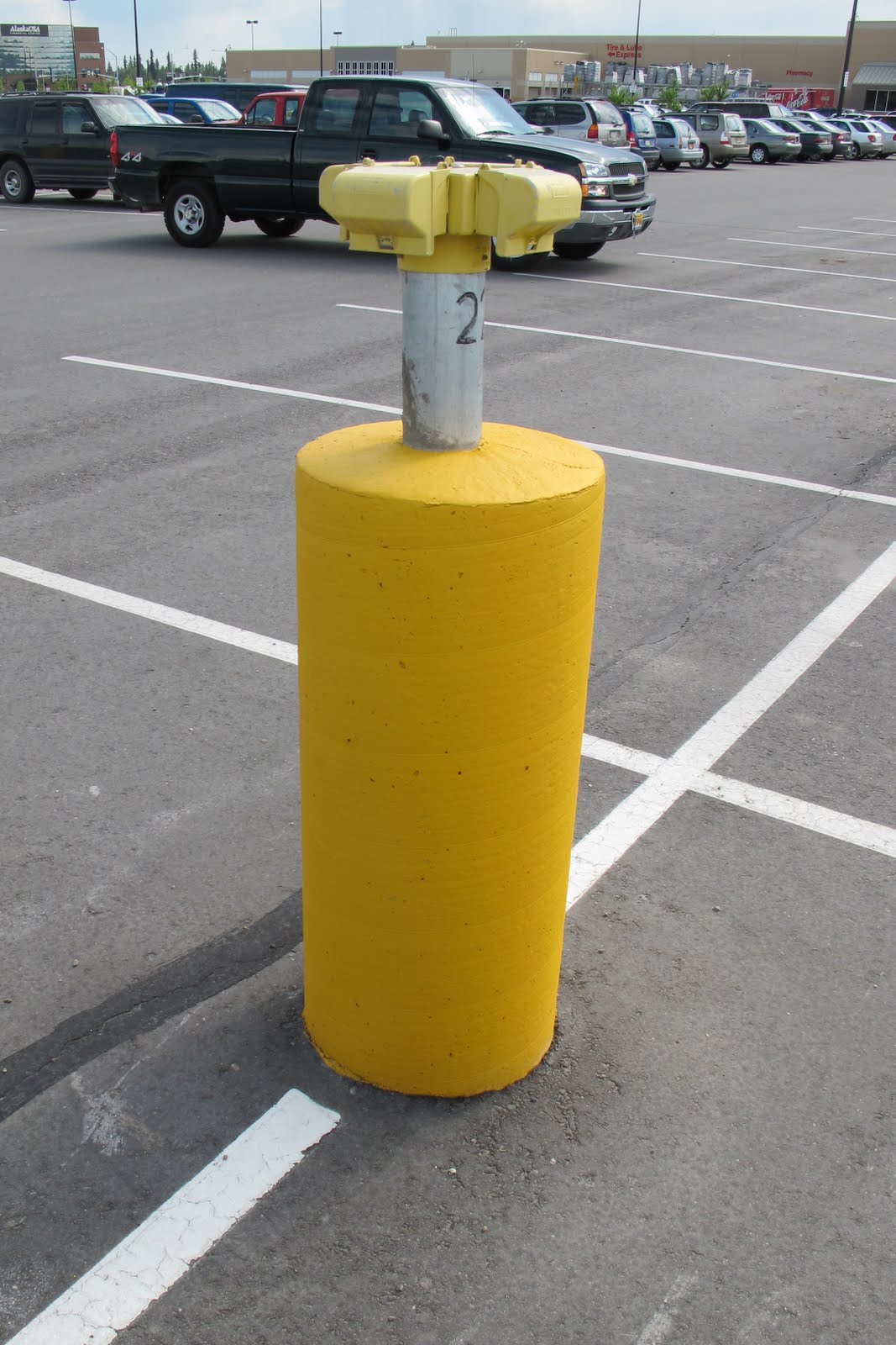

Found this in the parking lot behind the hotel I stayed at. You'll find them across Canada and sometimes in North Dakota, Montana and Minnesota. And no, they're not to just charge your phone.
One could theoretically charge an electric vehicle with a 110-120V outlet. I remember there was that infamous test of a Tesla by a New York Times reporter. I believe he said he needed a tow after it ran out. But he also said he plugged it in overnight using an extension cord at a motel.
Not sure how something like this would work trying to charge an electric car. I heard somewhere that most of these parking lot outlets are cycled on and off (maybe on then off every 30 minutes) because block heaters don't need to be on all the time.
And here's a Walmart in Alaska:
