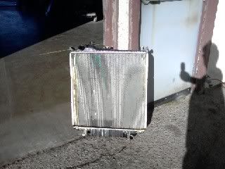

This radiator is out of a customers 2006 ford Explorer with 36,xxx miles on it. According to the customer it's only been serviced by the local dealer so coolant contaminaion is not very likely.
Ford would not cover it under the 3/36 warranty because it was 3 weeks out of warranty.....They wanted over $800 to replace the radiator. We did it for $550 and it's a major job since the condensor and radiator must come out as a unit which involves recharging the AC.
It looks like it has been leaking a long time.
Coolant Should be Ford Gold/GO-5 and it tests good with our test strips.
No electrolosis.
Cooling system is reasonably clean internally.
Thoughts as to what caused this? I'm not sure that I'm sold on Go-5. I'm seeing more and more of these problems.

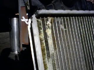

About the same, but I cant see anything. I see a growth of some sort on it, but I cannot tell anything else. Might have been a defective unit. If I was the customer I would bring it to Ford and raise heck. (figuratively speaking of course) Might not get anytinhg, but then again they might.

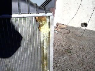

Ya all you can really see is the dried go-5 all over the core. The last pic is just the inside of the radiator after I took the plastic tank off to show that it's not full of rust or other nasties.

G05 tends to dry into big crusty boogers- more so than lots of other coolants.

What exactly failed here? Have you seen similar failures in other G05 systems? Did the tank gasket just leak?
Tube to header joints failed. Looks to be all the way across on both ends. My voltmeter showed no electrolosis with it off and with it running.
We replace alot of plastic/alum radiators but they usually make it to 80k or more before we see them. This was the newest vehicle I have seen at our shop and the 1st with these GO-5 boogers although my personal jeep had it's Go-5 turn to a brown mess in 2.5 years/28K.
It "just" leaked man. I'd telling your customer to push for Ford to cover the costs. That is unacceptable and clearly due to a long term leak that is caused by a design FLAW (not defect).
