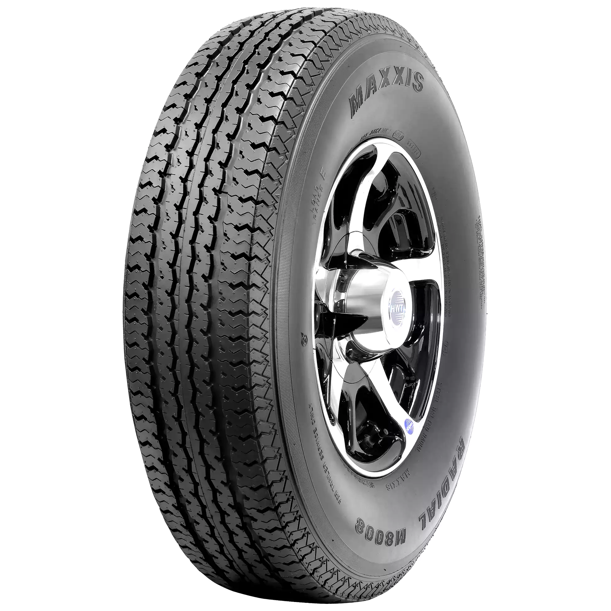

I have Maxxis trailer tires on my boat trailer and toy hauler, no issues at all. They both had 15" wheels and the RV forums seemed to say Maxxis was the way to go unless I wanted to buy new wheels too.

Our toyhauler came with Carlisle D "Maypop" tires, I brought it directly from the dealer to the tire shop to have the Maxxis E tires put on it.
