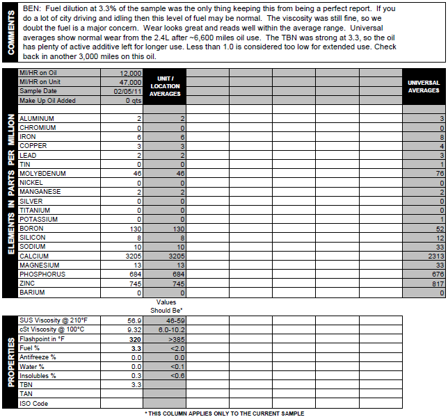

Hi everyone,
I'm a long time lurker here and I finally decided to get a UOA, here are the results:
Code:
VEHICLE 2005 Honda Accord DX 2.4L
OIL Amsoil 0w20
MILES IN USE 12k
MILES 47k
SAMPLE TAKEN 02/05/2011
ALUMINUM 2
CHROMIUM 0
IRON 6
COPPER 3
LEAD 2
TIN 0
MOLYBDENUM 46
NICKEL 0
MANGANESE 2
SILVER 0
TITANIUM 0
POTASSIUM 0
BORON 130
SILICON 8
SODIUM 10
CALCIUM 3205
MAGNESIUM 13
PHOSPHORUS 684
ZINC 745
BARIUM 0
SUS VIS 210ºF 56.9
cSt @ 100ºF 9.32
FLASHPOINT ºF 320
FUEL % 3.3
WATER/ANTIFREEZE 0
INSOLUBLES 0.3
TBN 3.3
The virgin TBN of this oil is supposed to be 12.1. Since it's down to 3.3 after 12k miles, does that mean I have about 4.5k miles of TBN left? I think that would support my planned 15k OCI (AMSOIL's severe service recommendation).

Different scales tell different tales. Virgin TBN their method would be likely less than 12. Plus it's not a linear scale. I would say (less the fuel) 18-20K shouldn't be a big issue. I likely missed it - what was the timespan of this OCI?
Originally Posted By: Pablo
How did you sample?
I sampled from the oil pan. My wife had just driven the car, she may not have been out long enough to cook off the fuel.

Interesting report. Thats a whole butt load of fuel though
I don't see how this is "normal"

That could be the reason for the fuel and everything else nominal. It's happened to me on both my cars - those times I was just being lazy and drove the cars around back to the oil change pad - dead cold. My fuel was OVER 5% IIRC. Shows you how much fuel some cars dump when they start cold. Just watch it next time.
I think all sampling should be done after the engine has been fully warmed up and ran for a good 20 mins on the highway to get everything nice and toasty.
Fuel in the sample just throws off the results, IMO.

Looks good. I have the same year engine. Fuel dilution is apparently an issue with some of them. Mine uses 1qt of oil every 4-5k miles. 140k.
Yea i service my neighbors 05 Accord with the 2.4L K series and Blackstone also found a small trace of fuel in the sample (taken VERY hot)

The KV100 of 9.32cSt is higher than the virgin PDS spec' of 9.0cSt.
I wonder what the KV100 would have been without the 3% fuel?
Since the Amsoil ASM 0W-20 doesn't have a very high VI (165) and shows no tendency to shear; it in fact thickens with mileage, I suspect this oil contains no VII's.
Originally Posted By: CATERHAM
Great result from a light "30wt oil".
I agree. Using no VII's is probably a good move for a 20 grade oil that has to last a very long time. Fuel dilution appears to destroy the VM's in some oils.
I've seen many API 0w/5w20's lose up to 12% of their original viscosity. ASM/Redline always stay in grade. I've seen a few M1 0w20's that lost about 7-10%. Those oils probably get a tad better fuel economy.
Yes, but thinking of this oil as a 20wt is something of a stretch.
Since all 5w30 dino's and most 30wt syn's shear to some extent, after a few 1,000 miles there will be virtually no difference in viscosity between Amsoil 0W-20 and a typical 30wt oil.
In fact I think it would be more practical to think of it as a shear stable alternative to M1 0W-30.
