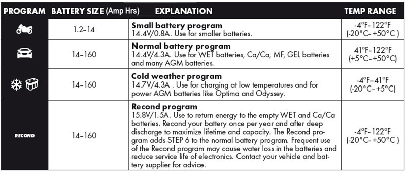

Interesting reading on what is being posted here. This is a chart from CTEK (https://smartercharger.com/), which many major car manufacture uses and rebrand as their own chargers. That list include notable companies such as Ferrari, Lamborghini, Audi, Mercedes, BMW and Porsche. I am not trying to argue because I know little to nothing on this topic. I have been using CTEK charger for almost 20 years now and remember seeing this chart in the CTEK's user's manual. I would love to learn more about this if someone can please explain the possible reasons behind this chart vs. what is being posted here. Thanks.
All I can tell you is that cold weather charge profile in your image doesn't align with the specs printed on my East Penn AGM battery.
The "normal battery program" which includes "many AGM batteries" would be more appropriate, but is still on the high side for this particular battery. What you need to realize is that AGM is more sensitive to temperature, so unless your charger compensates for temperature, it's best to err on the lower voltage setting, which would be the normal battery program. 14.4V would be just fine at 75 degrees with most any AGM, but if it's located under a hood on a long drive where the battery is maintaining 140F, 14.4V (absorption voltage) would be an overcharge. 14.4-14.7V is unlikely to hurt anything at normal ambient temps.
I don't speak for Optima, Odyssey and other high dollar "power" AGM batteries, one should consult the manufacturer for required charge characteristics.
