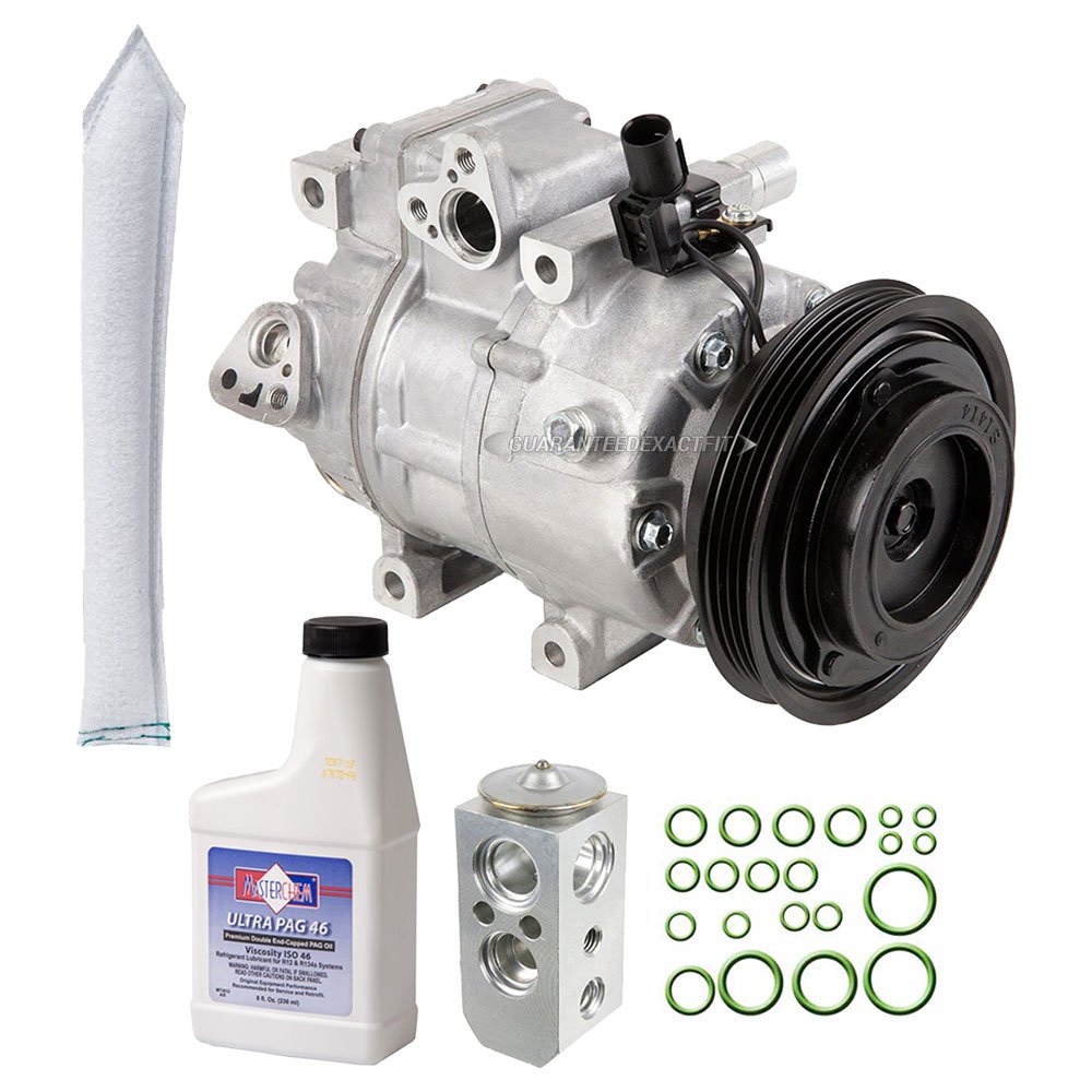

Here is a kit on Amazon. https://www.amazon.com/Compressor-Clutch-Complete-Repair-Hyundai/dp/B01MAWGV04/ref=sr_1_2?s=automotive&ie=UTF8&qid=1489964225&sr=1-2&keywords=New+AC+Compressor+%26+Clutch+With+Complete+A%2FC+Repair+Kit+For+Hyundai++accent
100% BRAND NEW, premium ISO/TS 16949 quality - tested to meet or exceed OEM specifications
Engineered for superior durability, backed by industry leading warranty
Included in this KIT: 100% BRAND NEW premium quality A/C compressor with clutch ; New accumulator / receiver drier / desiccant ; New expansion device ; Complete vehicle-specific o-ring seal kit ; correct viscosity PAG oil
