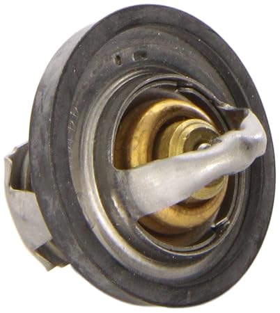

The thermostat is supposed to come with a seal around it that fits into the recess of the lower intake manifold. It won't drop in flush. There's supposed to be a squish factor when tightening the thermostat housing down onto the thermostat seal.

Theirs 2 sidebars,on the sides of the thermostat...that's what is I art preventing it from going in..couldn't I just cut those off? I saw an ad delco thermostat,on rockauto,picture showed out didn't have those sidebars.
The other factor,is the 2 ripped up looking areas both sides of intake thermostat seating..like someone took a strong piuck,and ripped up.
GM 24505924 or ACDelco 131120
It's supposed to look like this:
Well! I found out,their was half a thermostat in the intake. The top was ripped off,!and the bottom was missing...all it was,was the center ring,plus gasket,of the thermostat.sounds like chop shop stuff too me.
