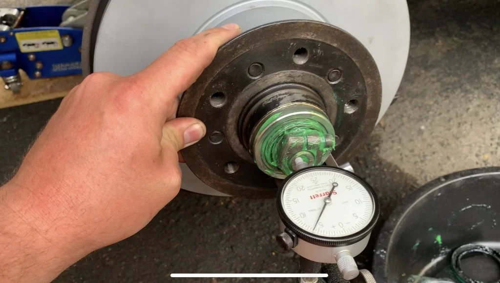

That has become my go too for most things and the 238 with 5% moly for ball and steering joints.
I love the stuff. I greased my track loader last fall when I parked it and then again when started running it again in February. The grease I purged was still nice and green, looked new. The Mystik never did that.
