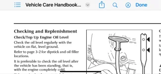

I’m not convinced of that . I don’t see any of that language in my Ford, Land Rover, or Jaguar manuals. The Jaguar manual specifically states that it’s preferable to check the oil level with the engine completely cold.
So it appears one can’t make a sweeping statement one way or the other on this subject.
From my Jag manual:
From my Jag manual:

The Jag manual covers 2000-2010 years. My XKR is a 2002. Photo below. The Ford manual says the same and it’s a 2014. I don’t have the Land Rover manual in front of me , but I think it covers multiple years too, from 2015-2020 IIRC.
