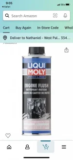

I forgot to add to this post that I used the attached flush prior to changing oil and was wondering how that would be reflected in the UOI??
You should have sampled before you added the flush. You pretty much invalidated your UOA. JMO. That's okay, you can get it next time around.
Flush requires running in engine for 15 min or so. So unless there is some siphon point I can use to extract sample the flush is a non starter. Are these pre treatments/flushes worthless? They smelled a lot like gasoline. Super pungent when it came out of the car. I would rather get a good read on the UOA than use the flush of that’s the case.
thx
If an LL-01 oil is used and it is changed at least every10k miles I seriously doubt that any sort of motor flush would be beneficial.
I had never added a flush before so it was a bit of a lark. I’ll pass on it next time. I wonder what it adds to or how it otherwise alters a UOA?
