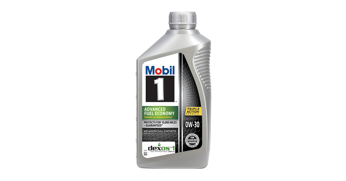

Mobil 1 5W30 meets Chrysler MS-6395, Mobil 1 also sells a 0w30 option as well if extreme cold weather is a concern.
https://www.mobil.com/en/lubricants/for-personal-vehicles/our-products/products/mobil-1-0w-30
