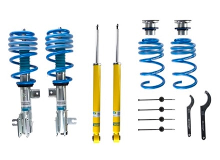

The B14/PSS are height-adjustable only with fixed damping, which makes no sense and isn't worth it.
Just get the Bilstein HD shocks :)
If you want adjustable, there's the Koni yellow
I am VERY strongly considering getting the Bilstein B14 for my Honda Fit 2012. Why do you think the B14 in general is a bad idea? Is it just the lack of adjustability?
If you adjust the height, you need to adjust the damping, too. The higher end coilovers will do this, such as Bilstein's own B16 aka PSS9 and PSS10

The B14 kit, will likely use their B8 monotubes, which is more than capable of handling its lowering range (20 to 40mm)

Bilstein B14 not available for my 3rd gen Mazda 3. That was according to Tire Rack. According to Bilstein, they are available. The only docs I can find on those B14s are in German. They don't seem to give details like the spring rates or how it affects the alignment.
I saw those, and several other coilover kits for the Mazda 3. I passed over them because they don't give actual spring rates, it looks like they're intended mainly for lowering, and most of the coilover kits have a more intensive install that requires drilling out the strut tower centers and installing camber plates to adjust the alignment.
