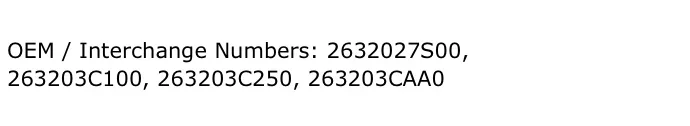

Oil filters I’ve used on previous changes have a little tab on the bottom that plugs into the housing. Just ordered a Hengst figuring it’s an OE supplier part, and no tab. Does any know what that tab does? Block a bypass passage? Or is it just there to align the filter in the housing?

We used champ P 989 filter. That tit or tan clicks into hole on bottom. If using filter without it at idle your oil lamp will come on. So the tan is necessary.
