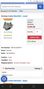

Does the part number in the catalog match your model year and motor? Tell him to fix it. Stop payment if you have to get his attention. It was a good enough part for him to take the job.
2003 buick century.....looks right?

Well update for anyone who cares:
I did some prerry hard investigating and found that eventhough the dealer website lists the part as a fit for the 2003 Buick Century, the manufacturer website, Dorman only lists it for the 2005 Buick Century and not my 2003 https://www.dormanproducts.com/p-106250-615-284.aspx?parttype=Intake%20Manifold&origin=keyword . It lists earlier model years of the 3.1 engine like on the chevy malibu all the way back to 2000. So now i guess i have to go with the mechanics idea of using a different MAF sensor or paying him to take the whole thing apart and redo with a used or reman lower intake manifold.
