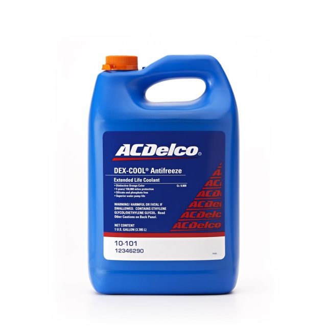

Been running the Prestone 50/50 Dexcool in my 2005 / 6.0 , since 2011 without any coolant related issues.
Dexcool is a fine extended life OAT coolant. Pretty cheap at Walmart for prestone dexcool concentrate. About $7 per gallon once mixed with some distilled water.
Prestone universal is a dexclone but neon green/fluorescent yellow in color. Also good.
Peak 10x is also good.
This time around I used dexcool as it was the cheapest I could find coolant for.

Based on responses, I think Dexcool is the way to go for now.
Thanks for the recommendations.
I am late to the party but I second the Dexcool recommendations. My 18 yr old trucl has run on Dexcool its entire life and there has not been a single coolant related issue yet. Original rad, water pump and heater core.
