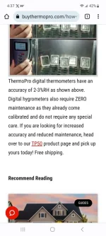

There is a calibration procedure for those digital temp/humidity gauges. I'd get a reading with another gauge. Almost 90% RH with a/c running means the building has serious problems, the a/c system has problems or the gauge is inaccurate.

I always used AcuRite brand meters back we the kids and I kept hermit crabs which require ~85% humidity all the time, and the cal check on them is done like this:
Pretty rare to find one off more than +/- 3%
Either way, even 70% humidity is too high in a situation like yours.

I’d go get a second $12 humidistat at Hone Depot to verify. I would be able to feel 80+% humidity the moment I walked into the apartment. That is a breeding ground for mold growth at that high of RH and not good for your lungs, furniture or the building itself.
I've currently got the hygrometer in a plastic bag with a salt filled soda cap and a few splashes of water. 3 1/2 hours to go.
