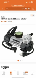

Husky has 2 small air compressors that look similar, same price, but one is 12 V and one is 120 V. Which one should I get? The Cherokee does have a 120 V outlet.

isnt that 150w outlet. if so it wont run a compressor.
so.. 12v... although many of those wont run from the 12v outlet without popping a fuse.
I'd vote for a VIAIR with battery clips.
they have went up in price like everything else.
The reviews on the husky make me think its worse than the 9.99 HF inflator.

someone gave me the husky 120v inflator as a gift. It’s not fast but it’s surprisingly good. Good enough that I bought a 12v for a roadside emergency kit. It’s piston and operation is probably identical, but it doesn’t seem to work as well. Now my roadside kit has a Vlair 88p.

I've had 2 cheapo compressors that plug into the 12v outlet go bad. One lasted roughly 3 years before seizing the other more or less failed within the warranty. The 120v is probably for a home outlet. Check but most automotive outlets are rated in watts no voltage.
